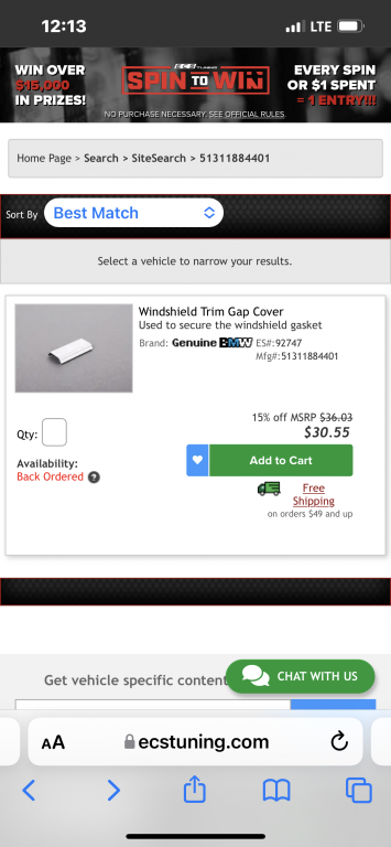

ECS Tuning sell it for $30.

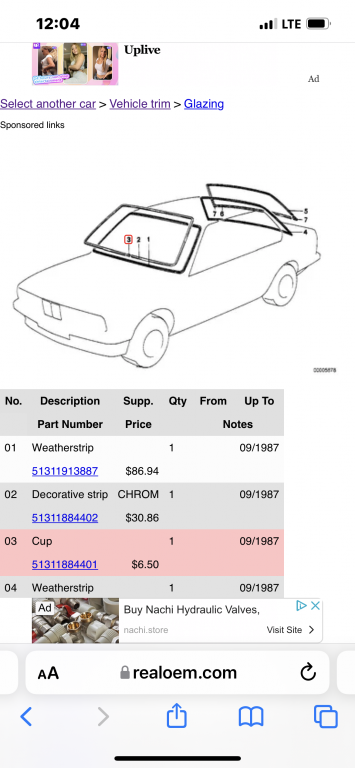

What I referred to as the “locking strip” is listed on that parts site as the “decorative strip”. Many people refer to it as a lockstrip or locking strip.Comment
