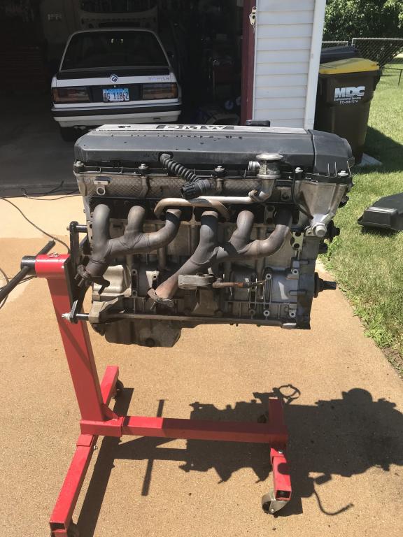

          Central locking is done. $500 in parts, $480 in labor. Wow. All 6 actuators were seized. Now they are all new and the driver's door lock is rebuilt. Fully functional. What a wild ride. With an old car I knew and accepted that there would be something. The project is still ongoing. Should be done by the end of August.
