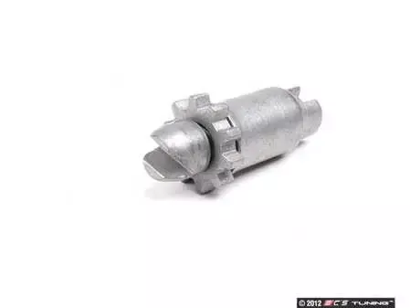

          the e-brake adjustment to loosen the shoes off is behind the hub. the rotor has to come off to get at it. it is the same type of adjuster as most drum type brakes. it is designed to tighten as it is used. you can tighten it externally but there is no way to loosen it.
          you'll probably have to remove the rotor, not bang it on.
          you're looking for this
          it's at the top behind the hub between the two brake shoe halves. should be backed off whenever you remove the rear rotors. it adjusts up after using the e-brake handle. the alternate is to button it up and send it, without being certain of the consequences.
