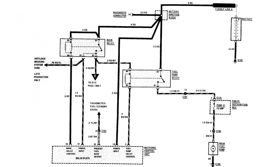

    I need a little help with my car. I recently installed a smaller walboro on my m30b35 swapped 89 325i as the old pump died. Car fired up and ran fine. I took it to the exhaust shop and they said it blew fuse 11 (fuel pump). When I got it home, I used a fused jumper to pins 30/87 which were getting power, however I am still not getting power at either side of fuse 11. Furthermore, I checked the C101 at pin 13 (fuel pump) and am not getting power at either side of the connector. The car will run with the pump hot wired to the positive terminal of the battery although it has a slight hesitation on acceleration and the throttle response isn't as crisp as I know it should be. Does anyone have any advice on what I could check? I dont want to just throw parts at this thing.

    The Walbro pulls more amps. You need to use a 10a or 15a fuse

                          fuse 11 is after the fuel pump relay, and is only energized when the main relay is powered. have you tried a good relay for both?

                            I believe I figured it out. I had a loose connection at the main power distribution block. On top of that, the previous owner had swapped the relay location of the fuel pump to the last position instead of the middle so once I figured all that out I swapped it around and got her going. Thanks for your help!
