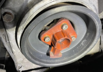

    • Verified there isn't a spring-like mechanism inside the distributor that might limit spark (see attached image)

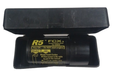

    • I've purchased one of the R5 FCX3 scan/reset tools. I initially tried to do the stomp test to get some codes from the CEL, but apparently the CEL isn't always wired up to the DME in some of the Euro cars?? That was fun to learn.
      • I plan to use this to hopefully get some info out of the DME

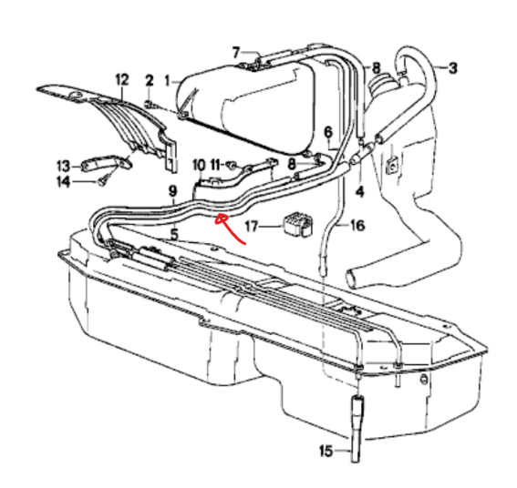

    • Unrelated (or maybe it is), I had a leak in one of the expansion tank fuel lines going from the top passenger side of the fuel tank to the expansion tank in the rear right tire well.
      • New lines on order to replace

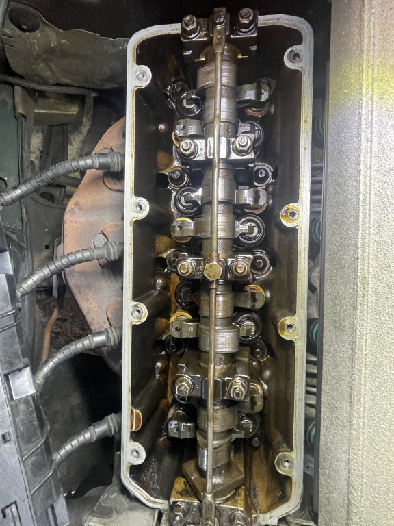

              • nhep23
                • Dec 2022
                • 11

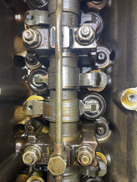

                Well that definitely doesn't look good!
ID:	10081492 Click image for larger version
                • roguetoaster
                  Biggus Tippus
                  • 7829

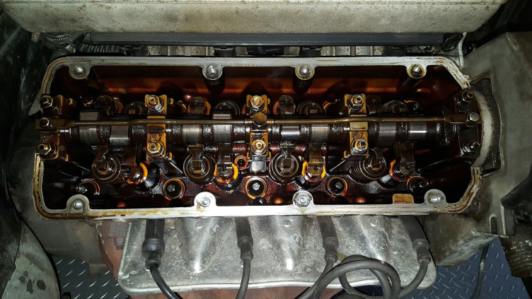

                  That's a classic M40 cam, at least your previous owner used synthetic oil, or maybe just believed in regular oil changes. Also noticed that you might have those optional plug wires that supposedly prevent whatever type of Euro pest from nibbling on the wires.
                  Here's mine before I changed it, and it was noticeably down on power:
                  Click image for larger version  Name:	AL9nZEXUzjwD206noedGjw_JVU9BQZR1iCeZEiAP2kOz9Y6bh4xLwzHOi-HdVae4tMeMt1dL-TUeloF0qeZwZXH-naKHD9c37MDqESdywfmvNyLrAPx1gk30ifCB9Bx-uRqqKAe5bOwzdLOdHHiIB5mttAtZBg=w1670-h940-no?authuser=0.jpg Views:	0 Size:	188.7 KB ID:	10081724
