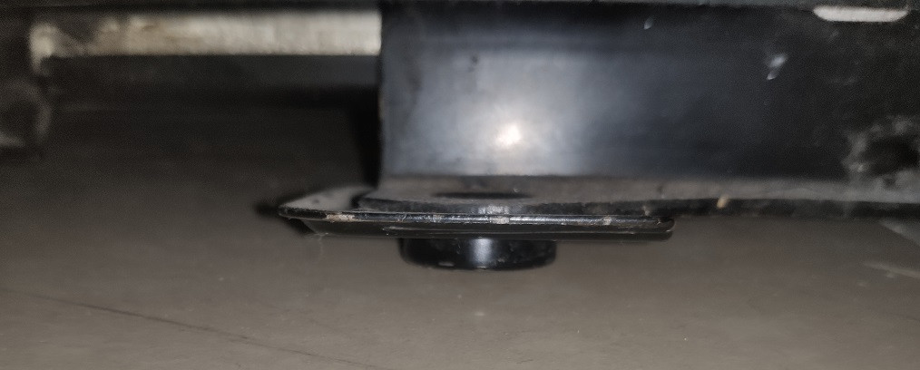

    These are my old seats:
    Here you can get a good idea of how thick the base is.
    It's around 3 millimeters for the lower round part and another 3-4 millimeters for the two layers up top.

    And then there are the new sport seats.
    I took these pictures in the car, this is the driver's seats btw:
    There is also that round part under this that you can't see in the picture. It's wedged into the carpet and it sits on the chassis.
    So as you can partly see, there's the round part under, then the first plate above that, then there's this neck part that looks like a nut but I'm not sure if it is cuz it's not threaded then why is it a hexagon, then there's actual rails up top and then I can put the nut on.

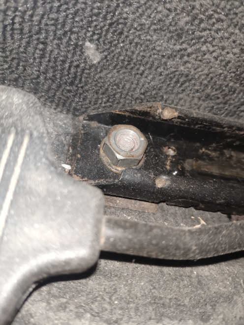

    Front left:
    The nut barely catches all the threads from the chassis.

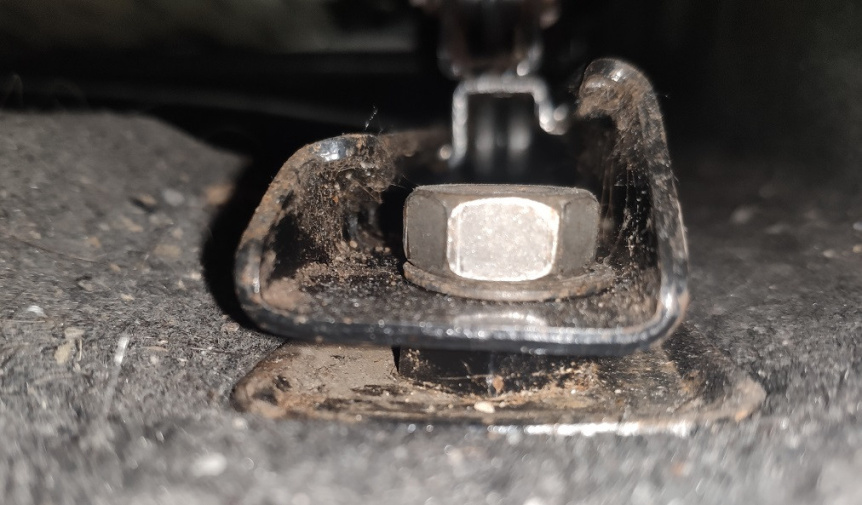

    Front right:
    Like, not great but not terrible.

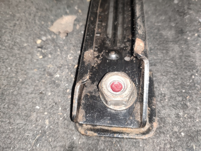

    Unfortunately it's much worse at the rear.
    Like that's just half the threads! Not good at all.
