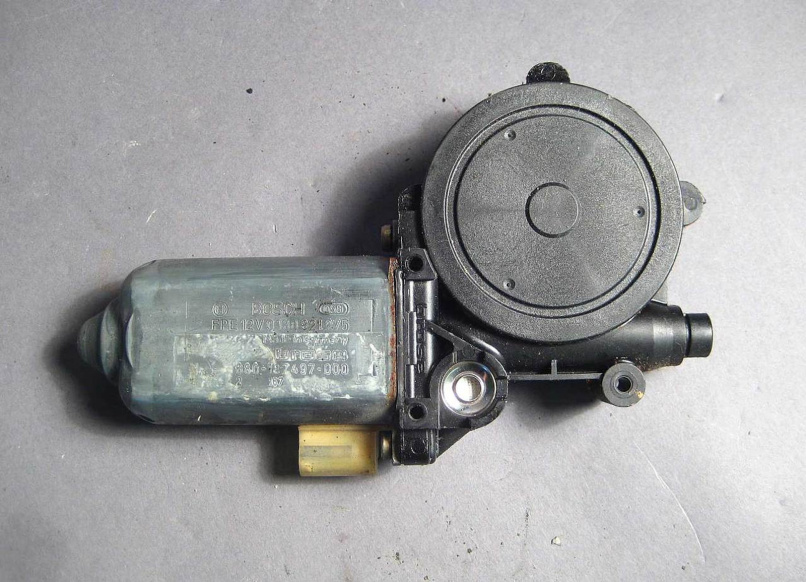

      • Vincenze
        • Apr 2019
        • 1044
        I can't guarantee that the electrical motor is identical in the series, but it may.
        Like this motor https://prussianmotors.com/bmw-e36-3...1998-oem-used/
        If you unscrew the metal part, it may fit.
