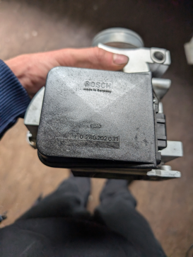

              I have an afm laying around from an euro 323i from 03/84 will look it up for you tomorrow.

                  picture does not work?
                    thanks,
                    jm
                    As it wouldn't let me change the picture, Afm number is 0 280202031.
