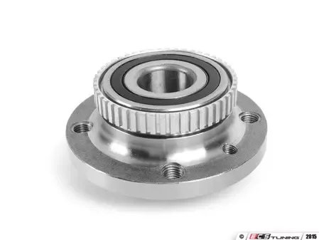

        Originally posted by nadodude111
        82eye thanks for the suggestion. Is the ABS ring the cavity the speed sensor sits in? Any cleaning how tos or recs is appreciated.
        thank you,
        it's a toothed ring on the hubs. it works the same as a cps. use a brass toothbrush sized brush to get at them. should be able to fit through the sensor holes, and probably get at them from the back as well.
