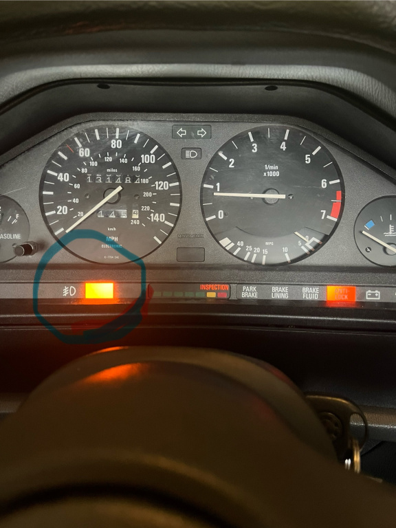

    What is this light on my dash?
    I’ve been searching all night and morning and can’t find a definitive answer as to what this (see pic) amber light is on my dash. My best guess is that it’s rear fog lights, but this is staying on whether my lights are on or not.
    my car is a 87 cabrio and I don’t have a rear fog button to put on, so I’m very confused.
    if it is rear fog light, why is it staying on and how do I fix this?

    Could be for the Rear Fog Light.

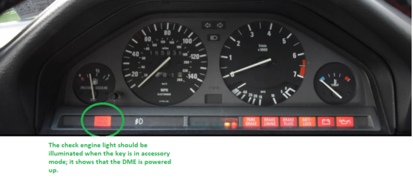

      Does your "Check Engine" light come on before you start the engine? The bulbs in that area are press fitted in some of the holes behind the cluster. Could it be that the check engine light bulb is in the wrong hole?

          Here is your check engine light. It lights up with the key in the accessory position. Does yours? If it doesn't, you may have put the bulb/socket in the wrong hole.

              The SI an CELs are not related. The slot to the right of the non lit fog light emblem is the rear fog light, which US cars don't have. Stomp test, if applicable to your car is key to the most forward position, engine off, and 5 full presses of the throttle pedal rapidly. Scanners that are compatible with an appropriate adapter may check codes on most E30s.

                    Do you have a 'dual' foglight switch like this to the left of the steering wheel? If so, then your car is or was equipped with a rear foglight. That's where to start investigating. If it's a single wide button or no button at all, then that gauge cluster light could be something else.

                      I do not have the dual buttons there. I simply have one large button for the front fog lights.

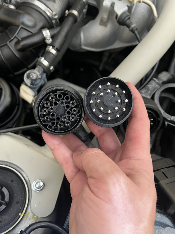

                        I’m having a difficult time getting my adapter to feel connected in anyway. Do I have the correct adapter?

                          After messing with this for a few hours, I had zero luck. Ended up disconnecting battery and seeing whaat happens. After 15 minutes of driving, the light came back and my rpm’ gauge has stopped working. Getting frustrated with wasting hours and making the car worse.
                          is there a different pin adapter I should be looking for to try to pull codes?
                          I’ve tried the stomp test, but had zero luck. (I’m wondering if that’s related to my light issue as well…)
                          • reelizmpro
                            • 9552
                            You disconnected the engine harness instead of the service port. The service port is at the front of the engine by the dipstick. Also, the stomp test may not work if you still have the early Motronic 1.1 (153) DME.
                              wow! What a complete arse I am. Thanks for pointing this out. Back to it.
