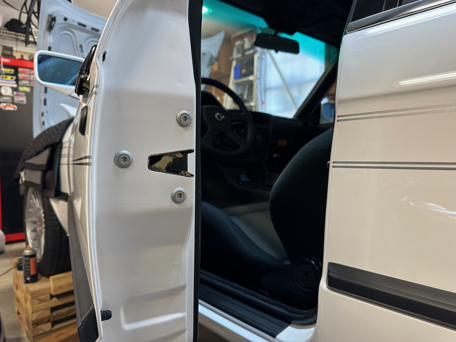

      I was experimenting with locks on my own as I didn't see that writeup when I did it. Therefore I wasn't aware about the inner plate being thicker on the drivers side vs the passenger. I didn't grind the lock like he did in the writeup and just put that clip in there. It pulled the cylinder a little into the door. It pretty much not visible as it's like a fraction of mm but my OCD knows it is there. Probably would be more pronounced if the paint was metallic.
      Here is a pic ...although it's almost impossible to see.
