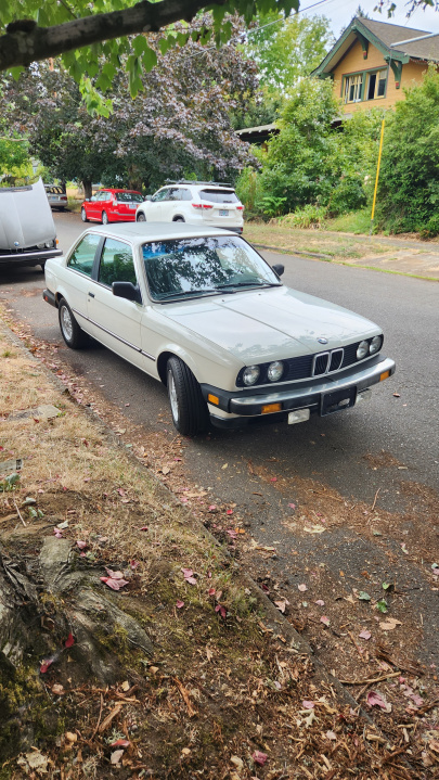

    Hi, possible new owner here and a newbie to BMWs. Porsche has been what I have been playing with for years. I met a guy in Portland who has a bunch of cars, including a few BMWs for sale. The most interesting one to me is a 1984 318i that is pretty heavily massaged and was an AC car but the system has been inop for years and the compressor was tossed. He has the rest of the bits. I have done some searching on the forums but am having a hard time finding the answer to this exact question. I live in a hot climate and normally wouldn't care about AC, but as I get older and wanting to do longer drives with buddies, daily drive it in the spring/summer/fall, AC is a must. AC Solutions has their kits, which don't list the earlier E30 M10 as being a car that one fits. When I contacted them, one of their folks thought one of their M3 kits would fit with some "massaging". Has anyone done this or another solution to resurrect the AC in these older M10s? Thanks in advance. Pic for attention.
