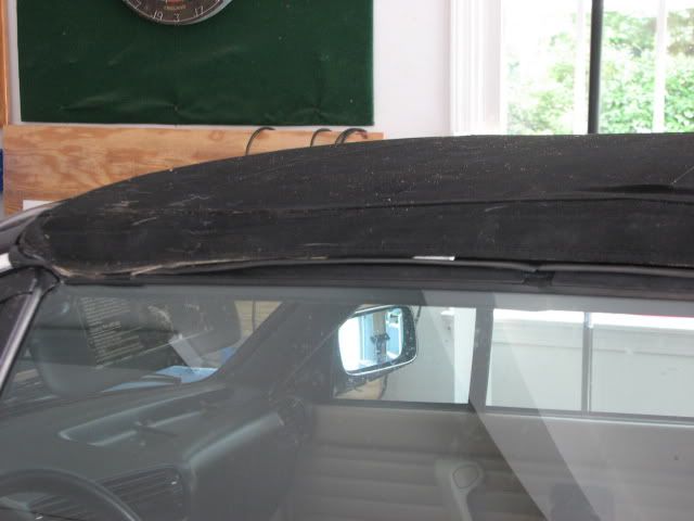

    i just picked up a '91 325i vert. it's in good shape but the roof leaks like crazy right at the A pilars.
    when i look at where the window seals meet the canvas top, there's about 1/8" gap...but i don't see any way for the top to "seal" to the seals...it looks like it is supposed to just rest on top of it...is this correct? is there some adjustment to be made to make the top meet the seals or is there supposed to be a gap?

      the weatherstrips don't need to come down any (towards the glass). if anything they need to be higher up (towards the canvas). the gap i'm talking about is between the canvas and the weather stripping. it's enough that if i'm sitting in the car, i can see daylight between the two.
      the strange thing is that i think this might be normal???? there doesn't seem to be any means of making the two come together.

        from your last post it sounds like your top isnt getting stretched tight, some pictures would help clarify but it sounds like youre saying that between the top frame rails and the canvas you have a gap, is that what you mean?

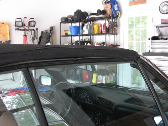

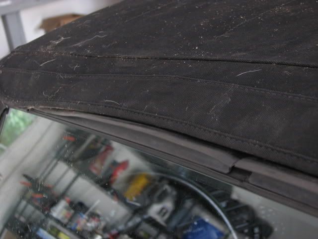

                      here's some pics

                          yeah knotcher it looks like your top is pulling away from the frame. in the second picture you can see where the cable should be attached and its not there. to the left side of the picture just below the canvas you can see a little metal loop , the cable runs through that.
                          is the top still attached to the cross bars inside, they like to rip free from the canvas.

                            i think it's threre, but it's loose.
                            so does the cable run under the lip of the seal? i guess i'm failing to see how, even when tight, the cable would pull the fabric closer to the seal.
