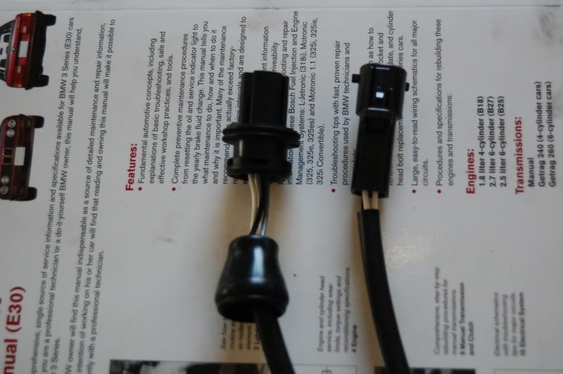

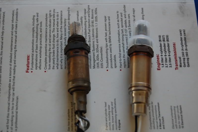

    So I thought I knew what I was doing with this, but after reading a few threads I'm not so sure. I bought a Mustang O2 sensor (part #13953) to adapt for my '89 325is. The new sensor has three wires, two white and one black, while the old one has two white, one black and one gray. I've read that you need to splice the wires of the new sensor into the OEM connector, but I'm not sure what that involves. Does the connector come off somehow? I thought I was just going to be soldering wires together, but I guess that's not the case. Any help is greatly appreciated. Thanks.
    Here are some pictures for reference. In both pics, the old sensor is on the left and the new one is on the right:

        The simple solution to this is to just get the correct OE sensor. But if you aren't going to do that, at least get the same Bosch part. Which will be a four wire sensor.

            I think I'm going to go with jlevie's suggestion and just exchange this one for a 4-wire sensor. I was misinformed by another thread that lead me to believe this one was the best way to go. I've since talked to my former coworker at Autozone and he says he'll let me exchange it.

              you need a 4 wire sensor for any car with motronic 1.1 or 1.3
              the extra wire is for the heater circuit. Don't use a 3 wire sensor in a car designed for a 4 wire sensor.
