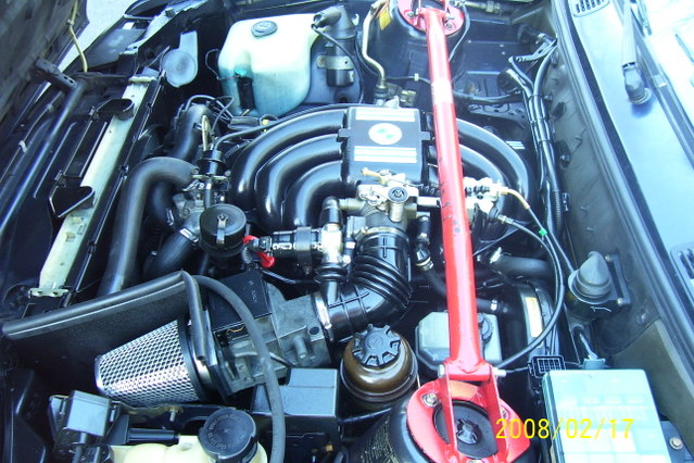

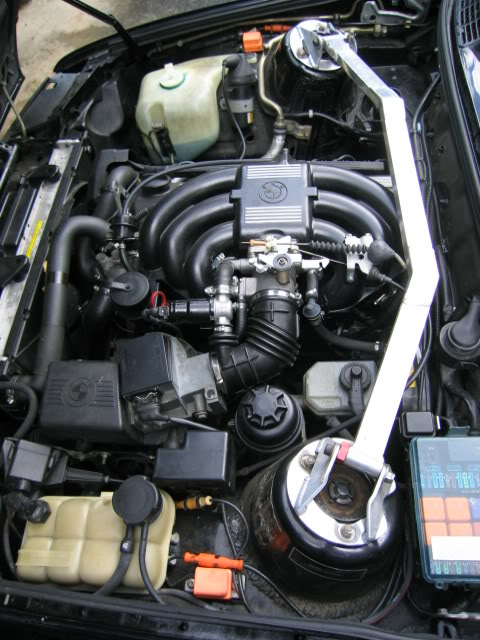

            Not all of them have the line going into the intake. I was looking through the engine bay thread and there are a couple eta's that just go from the throttle body to the booster. And this is what im curious about. Ill post the pics around 9 tonight.

              that motor isnt an ETA unless its a 2.7i. And what are you trying to do? MAybe if you let us know that, someone could give you some advice. if you are looking to route the vacuum line as shown in your pictures, then do so. There is no advantage having it either way. And other than your ECU throwing a CEL, you can run without that ICV no problem. The cold starts with be difficult but after 2 or 3 minutes it will idle just fine.

                Thank you, thats the answer i was looking for. Im trying to do just that. Eliminate another vacuum line going into the intake boot.
