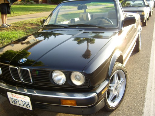

    Heres a pic of the car from the previous owner.
