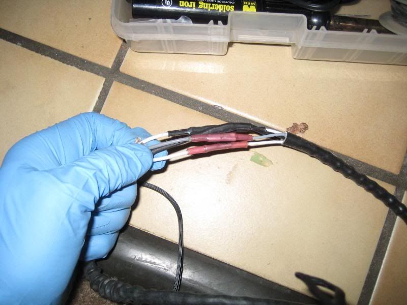

                    also this is how I spliced the wires on the 02 sensor. Is this a pretty good connection? Crimped then shrink wrapped.

                      Yep, that wiring should be fine.

                        ^yep. no probs there. Put some loom on the whole thing just to keep the weather off everything.
