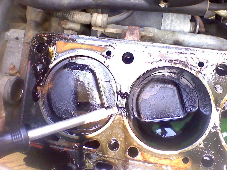

            it turned out that the injector wires were worn and shorting out on the fuel rail. but i didnt find that out till after i had replaced the fuel pump (w another used one) and icv and the dis-cap. the lean condition. which in trun caused the head gasket to burn out between 3 and 4.
            there is still a little haistation from time to time but im pretty sure its my wires or my fuel pump. new wires are on the floor at my feet right now.
            fuel pump ,AFM, and TPS will have to wait until $flow gets better...
