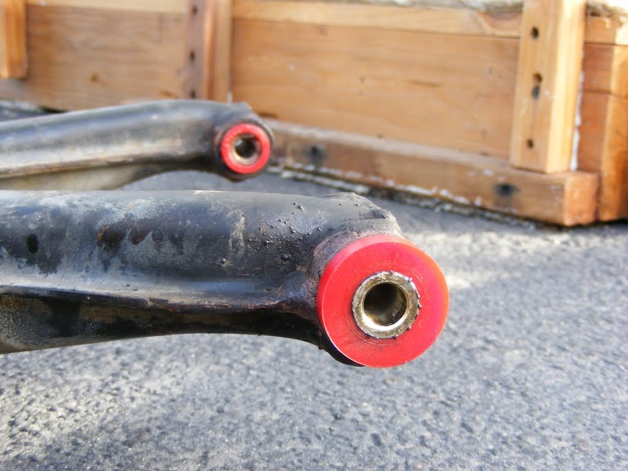

        Update
        So I solved it mostly. here is what a large part of it was this whole time: The rear trailing arms attach to the subframe through a bolt that goes through two tabs on the subframe, and through a steel tube/shaft that is inside the bushing that is inside the ends of the trailing arms.
        Turns out this whole time I have been wrong about how tight the bolts need to be. I thought that the steel tube needed to freely pivot within the subframe tabs/mount points. WROOONG!!!
        The whole idea is you tighten the piss out of the bolts, therefore securing the steel tube to the subframe, and the poly bushing actually slides around the steel tube. This way, there is no play, no tolerance, and a tight fit everywhere. I could use my crowbar to move the trailing arm mount points around, but not any more! No more clunking over bumps! There is more squeaking now, but that is normal w/ poly bushings.
        The only clunking that remains is a very small clunk when transferring load through the driveshaft, and I am convinced it is just the driveshaft.
        these are the steel tubes I am referring to, where the trailing arms mount to the subframe:
