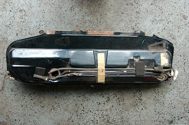

      I'm just curious what the process would be...The main and pre pump would probably be necessary if I want to install an accumulator as well right? I haven't been able to find any large pics showing the gas line arrangement.
      • ZM Blue Devil
        • Dec 2006
        • 13836
        I have a m20 tank, picture on the site, if you want other pictures to see how the lines go let me know and I can take it.

        • dude8383
          • Jan 2005
          • 10387
          Wow awesome.
          Can you get me close pics of the lines shown here:
          Strange that it doesn't have an opening on the left...or maybe thats from a 318i/is?
