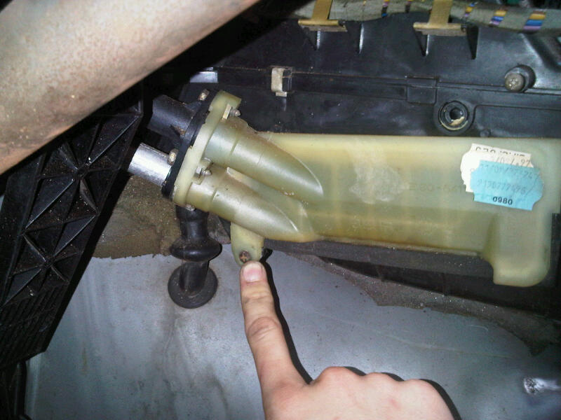

          Thanks for the replies. I already checked the elephant hose, it is clear. I am still getting a really small amount of water.. This is driver side, behind the HVAC unit. Let me get a picture of it...

            Is it warm water? Does it smell like colant?

              It is water. here is where it drips. A very small drip, only under heavy rainfall. The foam gasket which this part seals to also gets wet. Heater hoses are DRY, no water running from them. Water is coming from this part.
              Also, this isn't from running the A/C. The car does not run.
