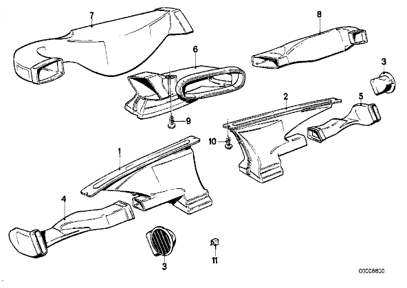

          Here is a pic of the dash layout. number 6,7,8 are cold air ducts while the others are warm.

                  Center is supposed to blow warm air, same as the rest of the ducts. You likely have something blocking air or a duct. Not sure if the heater core could be blocked like that...
                  E34s have a seperate outside air vent, e30s dont.

                    The weird part is that the same volume of air comes out of the center vents as the side vents, and they blow cold air with the A/C. Well, it was cold before my AC pump blew the rear seal out ;)
                    Meh. Anyone want to buy a rust-free '89 325i with center cold air vents? :)
