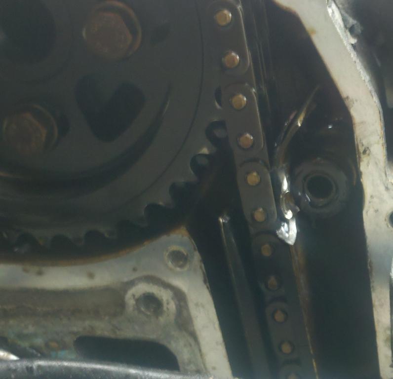

        That piece is a retainer for one of the timing chain guides if I remember right from taking mine apart....that would mean that somehow one of the bolts holding the guide in broke or fell out, and is probably sitting in the oil pan... can't say I've seen that one before, but your engine i likely okay as long as nothing got chewed up...

          It being an M42 its 98.342% most likely related to the timing chain,tensioners, guide rails.

              here is the spare engine thst I just pulled apart. Ill get my car towed here, and start tearing it apart to see what is going on with that engine. but it looks like this engine only had a blown headgasket, and a broken rail just as the one above you showed.
              I wonder what would be the cheapest way to do an R&R.
              just replace the engines as a whole, or pull the head of the other one. and just swap over.

                fifty.. finally got to work on mine before we got snow.. so this is what happened to mine.. luckly the bolt didnt brake in the head:)
