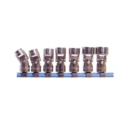

            The swivel socket mentioned above is just a u-joint for the socket.
            I just used the 3/8" socket attached to a u-joint, attached to a 1 foot extension, to the wrench. If you need the extra leverage, you can use a 3/8 to 1/2" adapter so you can use the larger 1/2" socket wrench.
              i think he meant he was using a socket that was 1/2" in size.. .as in an SAE sized socket...
              and these are swivel sockets
