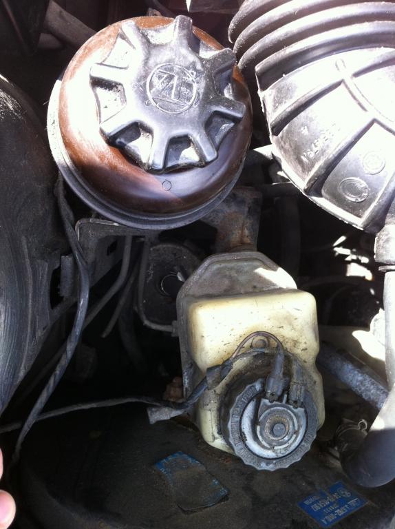

    can you post a picture of your fuel filter in your engine bay?

      It's the part all the way down there. I've read it has to be removed up out of the engine and not below, though I jacked it up to loosen some of the clamps from below

        That looks like the charcoal canister (emission control thing) check under your car near the rear wheel wells. I'll bet you that you'll have a fuel filter sitting there haha.

          right below the white canister is the charcoal canister, which is next to the fuel filter. I have an 86', they were located in the engine bay. Later models had the convenience of being on the drivers side by the wheel well.

            hmm i knew that some of the early models have an engine bay fuel filter, that sucks that its there though... can you remove anything to get more access? afm boot?

              Exactly my question! Can I remove those two reservoirs right there on top in the picture? If so can you tell me how? If I can I'm pretty sure I could slide it up once the brackets were loosened

                  You can unbolt the power steering reservoir and move it to the side. It's only one 10mm bolt.

                    I removed that bolt then tried to move it but it was also held in place by another metal bar that is like slipped into a divert just below the bolt hole. I tried to shimmy or move it around to take it out and move to the side but no luck.

                      The PS Reservoir slides up and out of the slot. Try pulling the bottom line from the fuel filter. Lossen the clamp on the fuel filter and it should slide up and out of the clamp. It's a tight fit, but do-able. Make sure you have a cap for the lower nipple on the fuel filter and the line or you will have gas everywhere!
