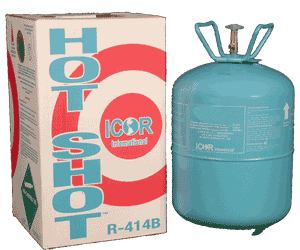

            Evacuation does not remove compressor oil from the system. You can pay for an r11 system flush to remove debris and oil, but $$$...
            This is why I recommended an r12 drop in vs. a full conversion.
            • mutty
              • 290
              They are not listening Ryann. 100% drop-in. No oil change or change of seals. And the only way to get all the oil out of the compressis to drain then flush. Pretty expensive and time consuming.
              • Ryann
                • 3350
                ^The only drawback with 414b vs. r12 is that it doesn't perform as well (much like 134a).
