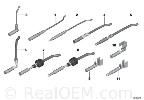

              Interesting, I'll try to work on that then. The benefit of the factory ordered connectors is that they come pigtail'd so you can just snap in to the housing and do the wire connecting. Not saying I'm above crimping my own wire of course, it just rules out choosing the wrong gauge wire, etc. For the time being, here are the diagrams with the stuff I believe i need...I need to look at those connectors again and take pics to be sure.
              I believe #7 is the coolant temp sensor housing i need. I can't find the 90* two port female plug for the washer pump (mine was blue) but it looks similar to #5; i think #5 is really a headlight plug. I don't see the black oval face two port female plug for the coolant level either.
              I think I need three #3s for the coolant temp sensor, two more for the windshield pump connector. I think I need #7s for the coolant level style plugs.

                  you can't go by the diagrams alone, there are around 6 different versions of #5 in the first diagram you posted each with different corners squared so they only plug into the correct item. That's why I asked for the list of what you need connectors for. I'm in from the garage for the night but if I don't end up getting sent out of town this weekend I'll work on getting some more common ones up.
