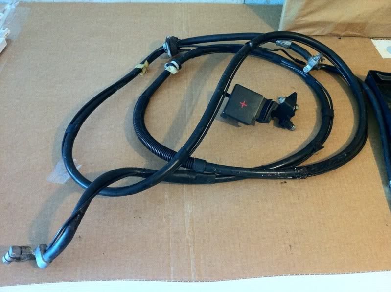

    Where does the cable go thru the fire wall?
    I have the stock parts, wires and trays to do the install. When I went to run the cable aft to the trunk I expected to see a punch out, plug or shape that matched the fire wall grommet. Any pics or incite is appreciated.
    [IMG][/IMG]

    it is on the right lower corner of the trunk wall.
      Thanks, do you know where it leeds thru the fire wall?

        You have to drill a hole, everything else should be there for the most part. I just finished up mine on my cabrio.
