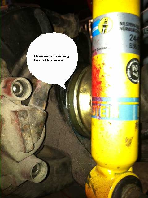

Please check out this picture. I am getting grease slinging from where noted. Do I need to replace the axle? Can not figure this out
Axle Grease leak 318is 1991

check if the boots are cracked :)
if yes, then the boots need replacement. Im guessing the inner ones also-
replacing complete axel may be less time consuming.OBD1 M54/M52TU swap as a M50b25

There is no outer boot on my 91 318is. The inner boot is in great shape. The grease is coming from where the axle goes into the wheel. Is there a seal in there? So confusedThe Lineup in order of appearance:

K I am stupid. Upon further inspection there is an outer boot. In lookin in my Bentley manual looks like I have a bad wheel bearing that is slinging grease. will tear into tomorrowThe Lineup in order of appearance:
