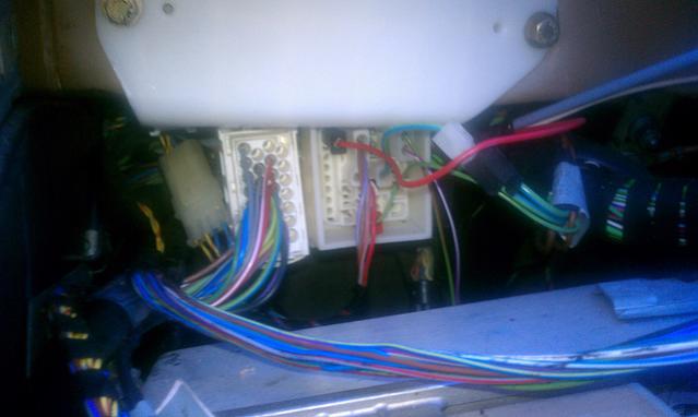

    Troubleshot all the recommended issues except bridging the starter posts because I didn't have a strong-enough wire. Replaced the K5/K7 relays and still no power windows. The AC blows OK.
    Since the dash-board is off, I'm able to trace all the wires locations, but I'm thinking that something might be array in the harness area.
    What else should I do to get the windows to power?
    Is there anything in this picture that looks like it's missing? I don't see any additional cables needing plugged, except I plugged the little black-two-prong cable that goes on the green fastener in back of the cluster. (There are 3 places it plugs in... WHICH ONE).

    Grab your testlight and see if you have power at the window switch first, then test the circuit breaker.
    If you do not own a test, hie thyself immediately to your local auto parts store or Mart of Wall and purchase one. Do NOT use a multimeter to test power, use a test light.
    Did you download the electrical troubleshooting manual (ETM) yet?

      I have a 12v test light.. What circuit breaker? I guess I should d-load the ETM.. NAAAAAAAAOOOOOOOOO...

        the pushbutton that kills window power is also a circuit breaker.
        BTW, the unloader relays are fine or you would have no HVAC fan
