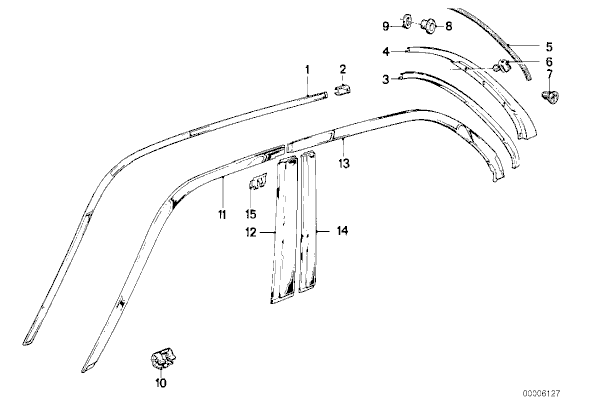

    I'm seeing some water coming into the Jack area of the E30. I reset the seals around the rail lights and they are good now. After a few showers, I'm seeing the water in there. I have a drain hole, but I still am getting some CC's of water.
    I suspect the over the door trim (Item 4) that is loose and water might be coming in from the little plugs that hold it in place.
    Any suggestions?

            The antennae is out of the car, I've since covered the hole up with masking tape. I'll do the chalk test to see where the water is dripping from.. (Brilliant!)... Next is the trunk gasket, but my main concern is the "Air Moulding" over the door. Part #4 above. It doesn't settle in that flush..

                  The part #4 in that diagram creates a rain gutter, I don't think it is supposed to fit flush to the car. At least, mine doesn't.

                        there are 3 plastic grommets/gaskets (#8/#9) that hold part #4.....if they aren't 100% flush mounted into the hole of the body...it will leak. I took a hammer and had to lightly tap these in when i replaced the grommets.
