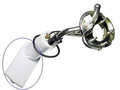

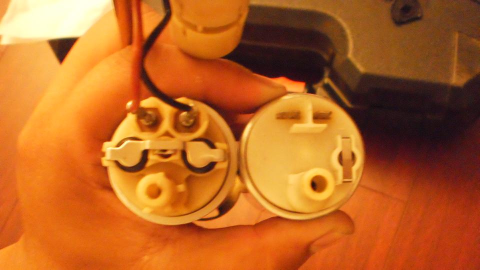

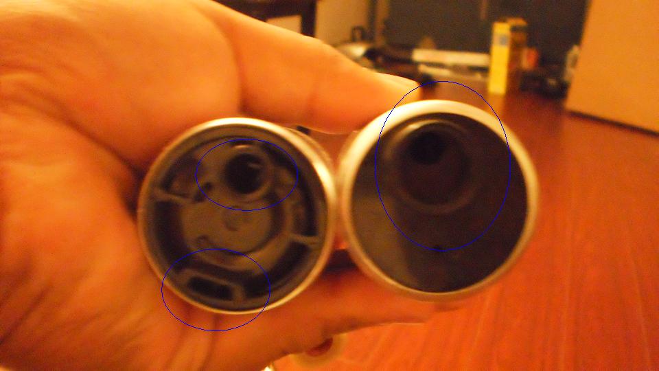

            After putting new gas and running it, on some streets/freeway. It died again. I decided just to change the fuel pump all together but heres the question. Bought a used fuel pump for the meanwhile while I can save up the money to buy a new one, I just need something that can work while I go to work for few weeks. Ended up picking this one up but for some reason it didn't fit the housing of the stock one, technically it dose but the bottom part can't connect. Can I just leave out the bottom part and just run the pump by itself?(Left is the original Bosch part and the Right is the replacement) I know the top parts are pretty much ok, the bottom part is confusing, 1st It has 2 slots to open and on the 2nd one it has just 1 big hole. The 3rd picture is the part I'm asking if it's ok for me not to have.

              its an early pump thats why the bottom doesn't fit. I would at least zip tie a piece of cheese cloth or something under it. Your pump will burn out if it sucks up any debris
