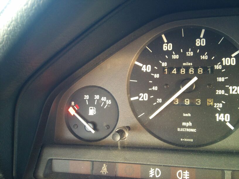

                        • Jrey
                          • Nov 2011
                          • 575
                          Originally posted by Killacortes
                          With the car running or just in the on position?
                          With the car completely off then once you do all that put it to the ON position
                          I have a pic of it showing the reserve light on after the red line but my gauge is not accurate though
                          Sent from my X10 using Tapatalk
