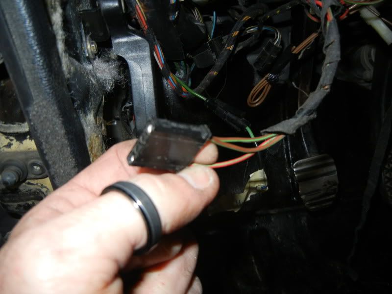

    I've been through the Bentley wiring diagrams half a dozen times, and either I'm blind or it's not in there.
    Connector is rectangular with pins in the #1 and #4 positions (2 and 3 are blanks).
    Going into connector are two brown/green stripe and one red/green stripe.
    Only brown/green stripe I can find in Bentley is associated with the fuel gauge, and I can't find a red/green anywhere.
    Any wiring gurus that could help out, or anyone who recognizes this connector? It's under the left side of the dash. Wires run to the main loom and back behind the dash.

    Correct me if I'm wrong but I believe that wire is for the door chime thats attached to the kick panel, there might be a second wire that looks identical to the one your holding that attaches to the door chime as well. I disconnected the door chime on my car because it was damn annoying.

      thanks, that could explain why I can't find anything that it would plug into, since there is no door chime module anymore!

        +1 for door chime.
