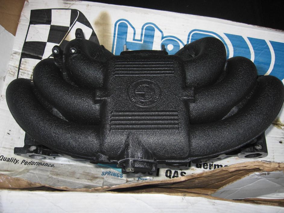

                I guess I will pull the whole manifold... and paint it while it is off. Fun!
                Would normal spray paint be OK? It doesnt get "that" hot
                why pull the manifold if the starter is out? Unless you changed your mind at some point and want to do this? if you do take it out. putting the starter back in while the manifold is off will make installation much easier.
                I would get the manifold sand blasted first before painting and prepped properly otherwise the paint will eventually peel. it can't have any wax (which is does from the factory undercoat) and any oil etc on it. Clean it real good. You can also get the crinkle spray paint out there. remember to make life easier, put the starter in first. :-)

                  Well a local guy is powdercoating my intake mani for me for only $40. Pretty awesome
                  So I am checking my ground today afterschool and if it is good... Im pulling the airbox and the intake boot... and if I have time the intake manifold/throttle body

                    I just paid 120.00 for crinkle black powder coated intake plus my 2 hours traveling time and gas. consider that a sweeeeeet deal!! take it!

                      Yup.. he is about 10 minutes away. It is looking like I have to buy a pound of powder though to get the color I want.
                      $25 shipped for a lb of powder... I wish people didn't gouge on shipping

                              Anyways. He quoted me $55 for my valve cover and intake manifold! I am so happy, now I just got to buy the powder! I cant decide what color!

                                Just hope that he preps it properly otherwise the paint will chip easy..so make sure cheap price isn't always quality work..just make sure..
