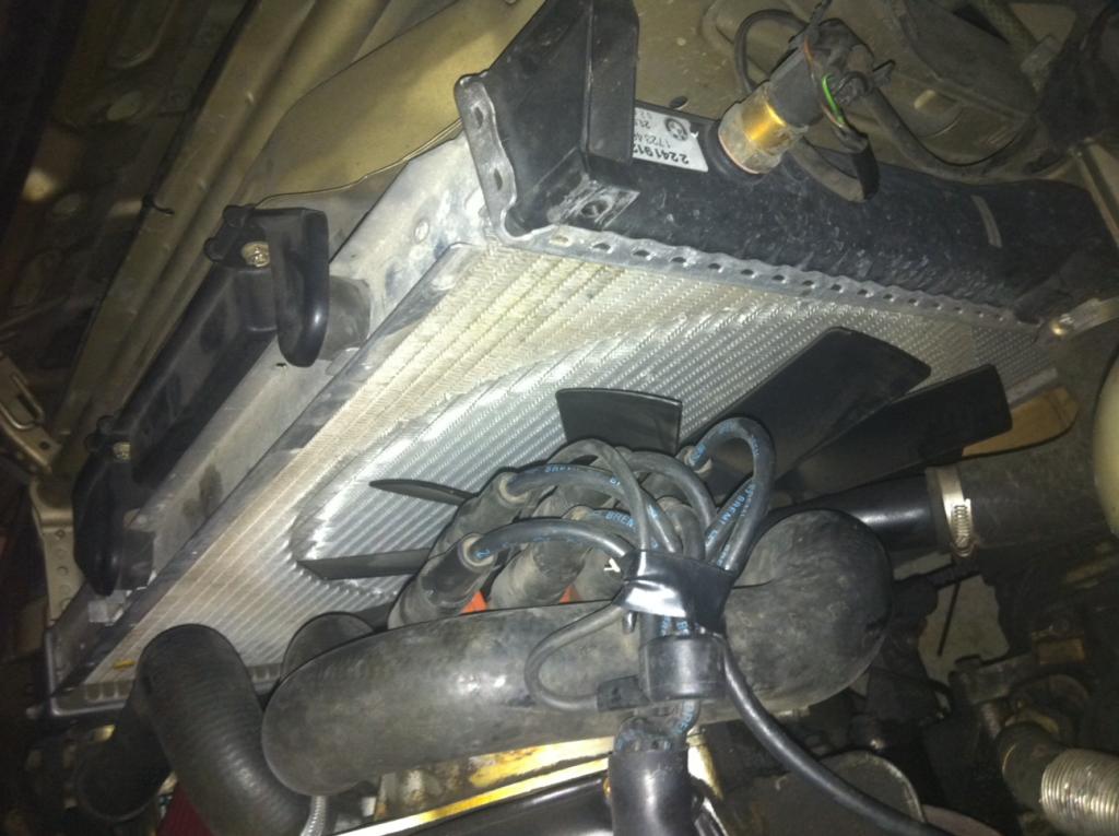

        Heres a pic of how bad is got
        • accident
          • 7303
          Originally posted by 110stx
          Bad motor mounts.
          Seconded.

              MOTOR MOUNTS
              Replace them

                About to buy some right now. Thanks, But thats only the fan hitting the radiator problem. What about the vibrations? do you have an idea on what it could be?

                  What about the bar underneath the radiator? That was the culprit when my clutch fan broke a couple months ago. If it's bent, that might cause a problem.
                    The motor mounts also act as a vibration dampener. Since the mounts are bad, there's no more dampening.

                      In almost all cases a failure of the CSB will be caused by binding u-joints in the drive shaft. Replacement of just the CSB may, or may not, provide temporary relief, but the new CSB will have a very short life and some vibration will still be present. The only cure is to replace the drive shaft with a new or rebuilt part. A rebuilt normally comes with a new CSB installed.
                      As to the fan, replace the motor and transmission mounts.
