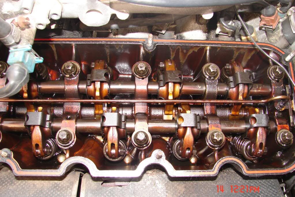

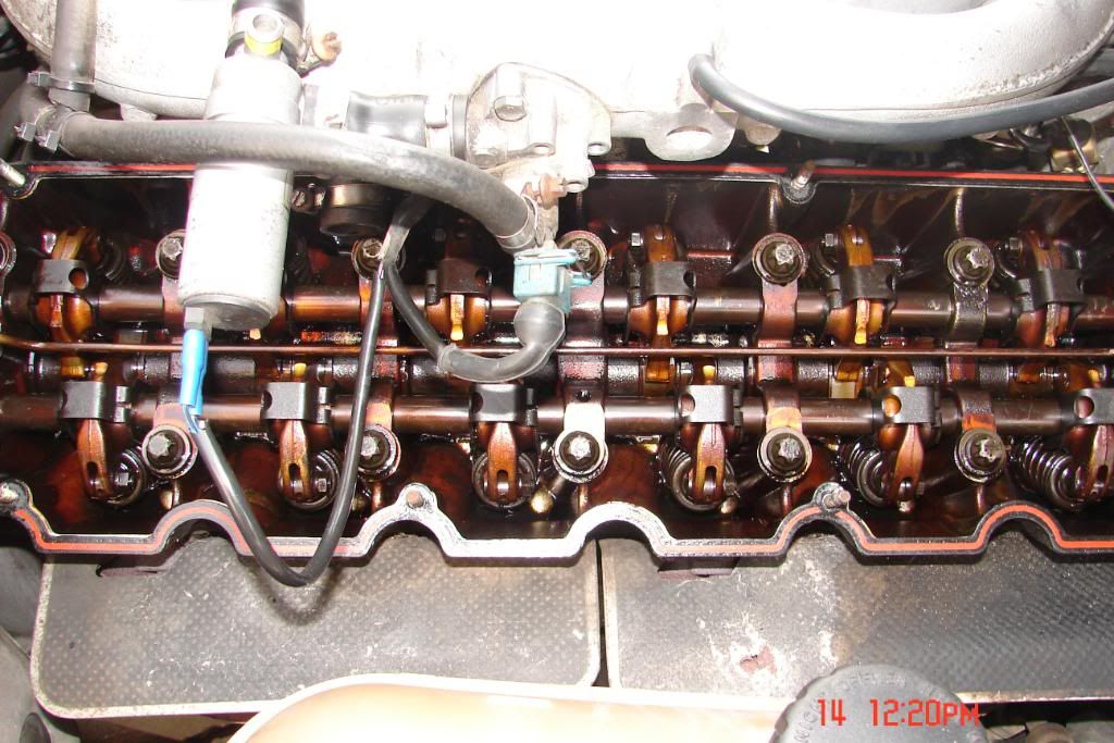

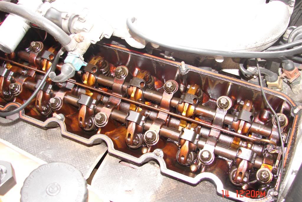

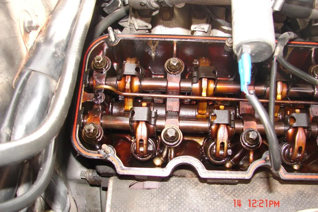

                      can you guys take a look at the pics and let me know how the inards look to your traind eyes as mine are not.

                        Looks pretty good for a 20'sh year old engine.

                          it looks like the previous owners neglected the oil. Its very dark. But other than the sludge, everything looks to be in order.
