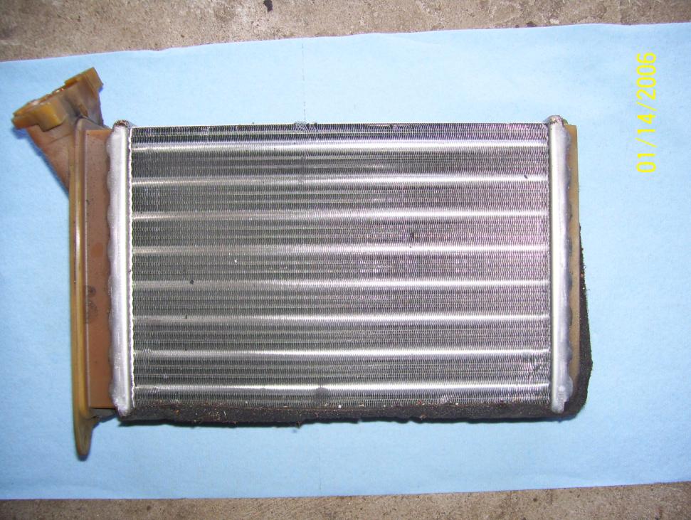

      E30's have two designs. The vast majority have both the inlet and outlet pipes right next to each other as they join the core. There are some models where they are not.
      The rarer one looks like this:
      The much more common one looks like this:
      I have a used one of these that I can sell you for cheap if you need to get back on the road in a hurry. I'd encourage you to replace your heater valve, the pipes to the engine bay and all the o-rings while you're down there.
      Take the center console out and look under your dash on the drivers side, the core exits the center area into the footwell and you can ID which type you have.
