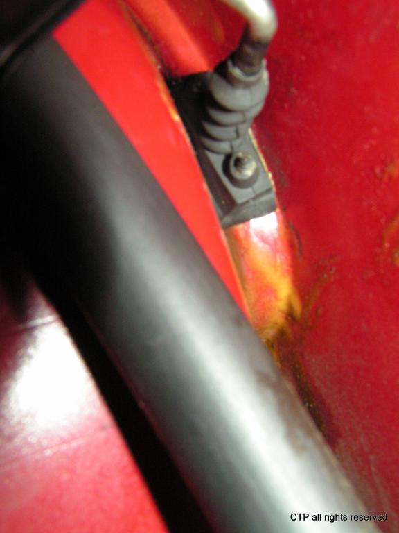

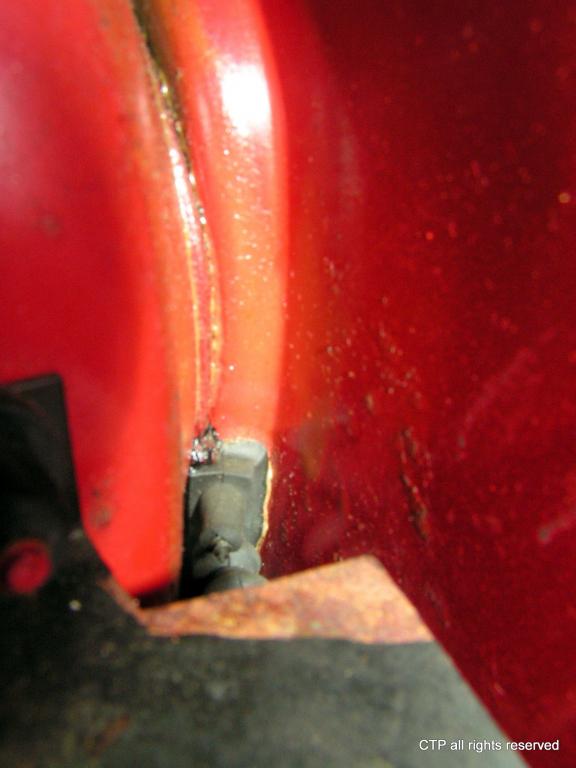

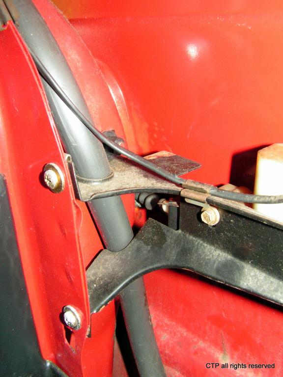

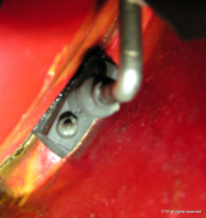

        I took these pics, then got too busy at work to post. Hope they help.

          perfect thank you! I have that piece back there...just checked. Gonna see if i can align it properly to the screw so it catches. Thanks a bunch! i owe you one =)

              ok so i was able to locate the black thing you took a picture of, and it wasn't reaching the screw. So i finally got it to reach (one arm in the trunk, the other screwing it)....and it was tight. I took a hose to it.....and it was still leaking water into the trunk!!! ughhhhhhhhhh
              I tried plan B....which was to disconnect the actuator, and used a thin piece of rubber ...sort of as a gasket between the body of the car and the black piece thats held in by 2 screws (that i initially took a pic of)....what was good here is the rubber completely covered over the pin.....but that didn't work. Was still allowing water to penetrate.
              btw I'm 100% sure its coming from this area as I hose down every inch around it....and cancelled everything out but.
              So I'm going w/ plan C for now....until I can find another remedy....which is siliconing the 2 holes + the area around the pin. Since I disconnected the actuator, its not gonna pop out if i lock the doors.
              what a PITA!!!

                      If you look at the pic below...there are 2 sets of holes (2 layers of sheet metal)....My only logical way of thinking here is that the water is dribbling between that gap, and running water into the trunk.
                      Last night I took aluminum/silver colored silicone & dabbed it all around the rod (i disconnected the actuator) & 2 holes for now....until I can figure out a solution.
