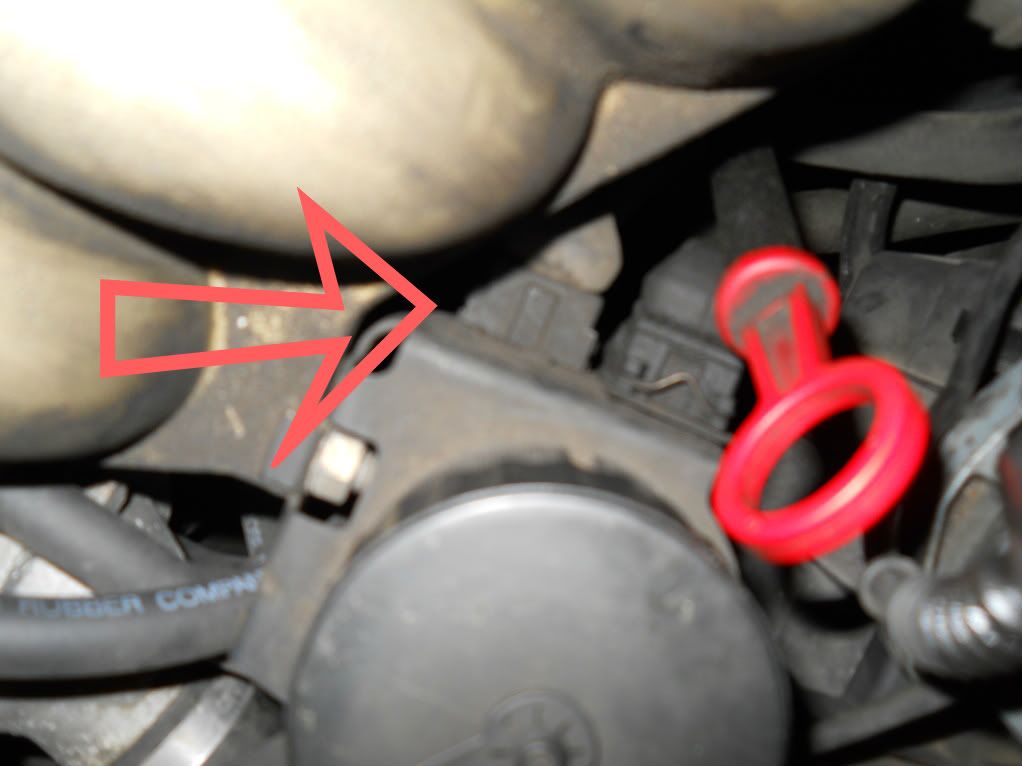

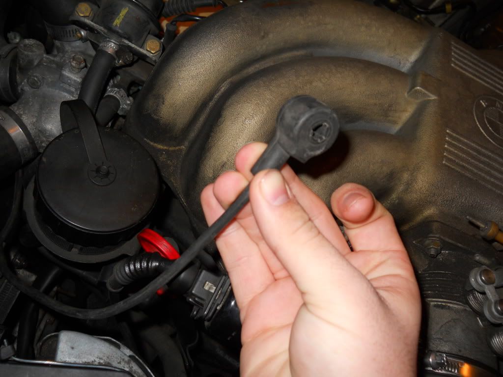

    What does this wire go too!!!!
    Its a 90 2 door 325i with the stock engine and does run.. the first picture shows the unpluged end and the 2nd shows where the wire is plug in too (the one to the left.. My tac doesnt work.. Could it have something to do with it.. could anyone tell/ show me where it goes?

    it's an inductive pickup and goes around your #1 spark plug wire (your plug wire goes through it)
      Which side is #1 and how do i get it on?
        #1 is closest to the radiator. Normally that sensor comes assembled on the set of plug wires, so it will depend on how yours are made. You will need to remove the boot on one end of the wire to slide that sensor on.

          It goes on the #6 wire, not the #1
          Its so the engine knows what stroke its on so it can fire the injectors in banks of 3, instead of firing all 6 at once (which yours is doing due to being unplugged) mine was messed up, put a new one on...makes no difference in performance, maybe a marginal difference in gas mileage.

              FLG is correct, i just assumed (incorrectly) it was #1.
              It goes on 6 as seen on my car:
                  number 6 is closest to the radiator...
                    No sir. Almost every engine ever made has cyl #1 on the water pump end. This includes M20s.
