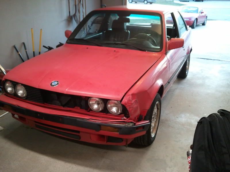

                        Just took a quick pic after I pulled it in the garage this evening. Ran great on the way home, lights started to get just a bit dim after about 10 miles. After it warmed up it seemed the exhaust was making even more noise.
                        Looked through the records and from about 2003 and 2008 the car was driven a total of about 8,000 miles. Regular oil changes, oil pan replaced in 03, some miscellaneous seals, a tie rod, and window switches and such along the way. Plugs and wires at 205,000 miles. In 2002 at about 185,000 miles a used transmission was installed with 109,000 miles on it, along with a new clutch and rear main seal. No record of any timing work, so I'll be at least getting a tensioner and guides.
                        Thanks for the tip on the voltage regulator, I'll check that out as soon as I finish eating dinner in a bit. Going to be getting the car up on jack stands tonight and beginning my inspection and fluid changes.
                        Question: car runs great, gets to temperature well, etc. The only thing is when I pulled it in the garage there was just a bit of coolant smell and a little steam looking like it was coming from the driver's side and rear of engine. Seemed maybe a little seepage from the freaking rat's nest of hoses under the intake. Seem like a probable cause?
                        Many more pictures to come! So far I have to say I'm pleased for $900.

                          It looks good :)

                            Hey, homie.
                            Is that a slicktop?
