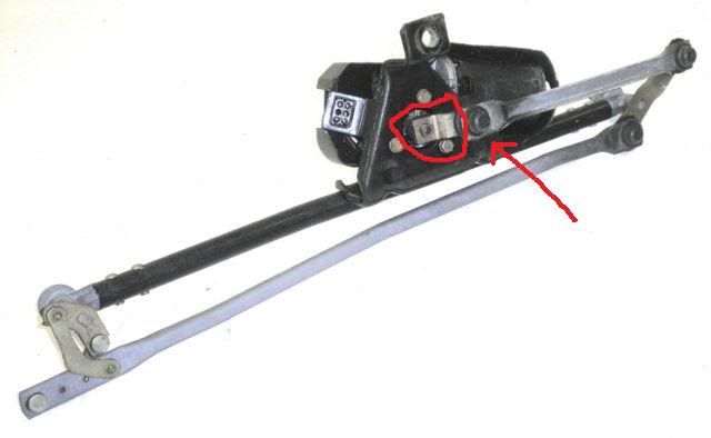

    Replacing my wiper linkage with a monowiper linkage and I am having trouble remembering how the linkage was sitting - I uninstalled and removed everything about a month ago but didn't put the new one in because I realized that my motor had failed. Any ideas on how this mounts up to the wiper motor?

    Your missing a piece that attaches to the motor and the other end to that arm, looks like an offset piece of metal, without that piece the arm would never rotate.

      Just realized this - I am missing that bracket piece. Is there anything else that I need? Anyone know the part number?
      The circled piece is what I am missing - also, I do not understand how the part that the arrow is pointing to mounts, can anyone explain?

        Im pretty sure it just pops onto the plastic piece and its held on by a nut onto the motor
        P/N - 61611370799
        Id give blunttech a call, im sure he could get it, maybe levent (guten parts) might have one lying around.
        Also missing the motor cover, though not required it helps keep water from getting onto things and ruining them prematurely.
        P/N 61611369586

          61611370799 is the Crank Arm. I ordered one from the dealer and it came in with no splines...very strange...so I got a used one.
          My question is how do you pop that ball on the end of the crank arm out or back in ? That rubber is hard as a rock and I bent my linkage arm and the ball still wouldn't pop out.
          The part the arrow points to is somehow pressed in to the metal linkage. I cant get it to come out either although Ive ordered a new one. I'll ask the dealer's service dept and post bvack if I get a solution
