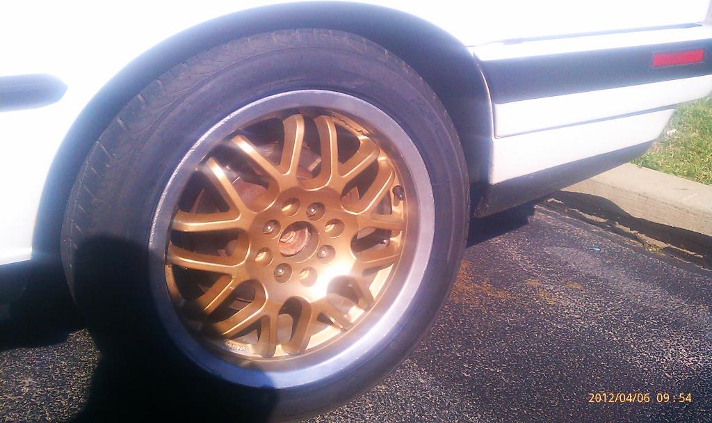

I have a 1989 BMW 325i 5spd. I recently installed new wheels 205/50/16 tires. I had the back wheels on 2 days early and everything was fine. Then I installed the front 2 and I got a Loud Clunking Noise from the Front end. So i took off the Front Right wheel and put the stock 195/65/14 rim/tire back on and I can go straight and make right perfectly fine. But the moment I turn to the left the clunking noise is back. Straight=Fine, Right=Fine, Left= Clunking Noise. Now If the Right wheel can handle the stock rim no problem then this means whatever the problem is I need to do it for both sides to be able to have both of my new wheels on. What is causing this clunking noise? Tie Rod's, Control Arm W/Ball Joints??

Does it just clunk once when you turn left, or does it keep clunking as the wheel turns? That will help you narrow it down, if it keeps clunking you can pretty much rule out things like tie rods, rack ends, etc. Id be looking at something in the hub or the brakes, maybe even the wheel not being seated properly. Jack the side up that is making noise and spin the wheel while it is bolted up and see.
You really need to know what the specs of your wheels are. if the 56.1mm is the hub centre, thats probably going to be your problem right there. The wheels won't fit on the e30 hub and will need to be drilled out. They probably won't be located properly and won't be seating flush with the hub. If the wheel wobbles when you spin it, or if you grab a hold of the wheel while in the air and try to wiggle it, you might have found your problem.Just a little project im working on

Now it makes sense. Well that was my noobie moment haha. I got to heated up with numbers that I got misguided. Thank You once again everybody for the assistance. The Wheels are not properly fitted for my E30. But its just crazy cause the Rear Wheels are perfect no noise. Just a Smooth ride. Well Time to get rid of these bad boys! FUCKkkkk!!Comment

if the 56.1mm is the hub bore, that's probably going to be your problem right there. The wheels won't fit on the e30 hub and will need to be bored out. They probably won't be located properly and won't be seating flush with the hub.Comment
Did you check if your wheel contact pads are not hitting your front brake brackets ? With my RS's I had to grind my brackets to fit them properly.E30S54 - Scale Suspension / Unix Performance Coilovers - 17x8 and 17x9 BBS E50Comment
