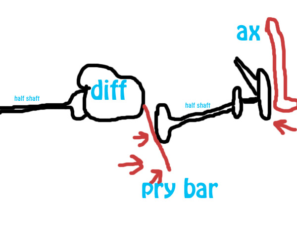

                    i made the mistake of putting grease on mine. they got stuck in the hub. the fit is so tight that even grease will be too much.
                    get ALL the grease off. it took me like 10 min per side to make sure they were 100% clean. spray some wd40 or liquid lube onto it and the hub. nothing thick at all. you want a very thin lube.
                    i had someone with a pry bar pressing against the diff and half shaft pushing it in. then i had to hit the hub with an ax.
                    no i'm not kidding. i had to literally hit the hub with the blunt side of an ax to shock it in. that's the ONLY thing that worked for me. i spent hours trying other things including rubber mallets hitting it.
                    be careful not to bend the hub lip if you try this method.

                      here's a diagram of exactly what i did. hopefully it helps.

                        ^ LOL I vote best diagram on R3v so far!
                        • b*saint
                          • 3794
                          What a ridiculous diagram LOL.
                          Ma che cazzo state dicendo? :|
                          • dothadance
                            • Jun 2011
                            • 1121
                            hahaha diagram is so awesome!
                            • peytonracer4
                              • May 2011
                              • 524
                              Lol no love? It was a ten second photoshop drawing. You understand the basics though. And if you'll notice... The colors are very accurate.
