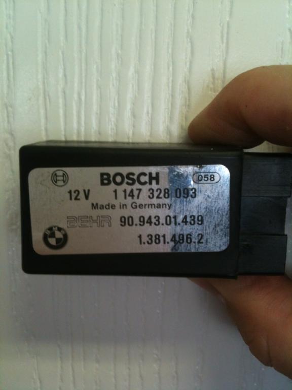

    Evaporator Temperature Regulator
    Foreword: This regulator has been discussed before, but no real answers.
    I was having issues with my compressor "short cycling". It would only receive the 12V ON signal momentarily for about 2 seconds.
    The pressure sensors (dual sensor setup), were receiving the 12V signal momentarily, so I followed it backwards in the system. According to the BMW ETM (old paper edition), and found the Evaporator Temperature Regulator.
    I jumped the 12V signal from the A/C snowflake button, to the output of the regulator/relay and the A/C WORKS! :D
    Now to solve the problem:
    The ETM shows "early production" and "late production". Early production cars didn't use this regulator, only the evaporator temperature switch. (opens to prevent evaporator icing)

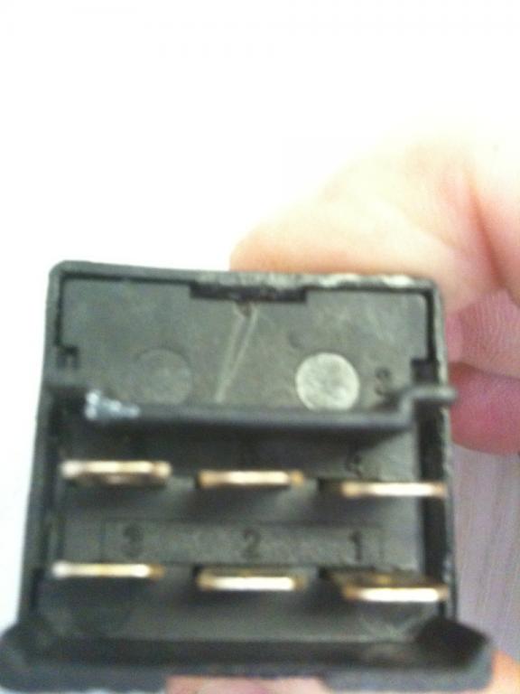

    1) This part new is too expensive and hard to find. Anyone got a used one?
    2)I wanted to find another 6-pin relay to wire in, but the regulator has some sort of circuit board with processor chips, probably for temperature control.
    3)Can I bypass the regulator completely? Since the old cars used only the sensor?

    Wow no replies. I'm going to bypass it with a jumper wire. I don't think anything will fry.
    • jlevie
      • Nov 2006
      • 13530
      I'd think you could replace that part with the early evaporator temperature switch. Simply wiring around it would work and if the system is converted to R134a there is very little risk of the evaporator going below freezing in temps where you'd want to have A/C on.

          I was wrong!
          The high pressure sensor returns a signal to the ETR.
          So I am converting the dual refrigerant pressure switch system to the updated single sensor/switch.

            Does anyone know where the Evaporative Temperature Regulator is located in a 1987 325es? The Bentley Manual isn't very helpful and for some reason and can't see any pictures on this forum. I'm hoping I can get to it without removing the dash. A general description would be great. I want to jumper it to see if it is causing my AC problems.
            Currently I'm not getting power to my compressor but both of my high and low pressure switches show continuity. I want to jumper 3, 5.
            • Das Delfin
              • Sep 2014
              • 2293
              take out the lower steering column cover and stick a flashlight up near the heater box. Look behind the footwell vent. The evap reg is the black relay looking thing tucked up behind there with a metal clip on top. You have to really get your head in there. Twist the bottom toward you (the bottom being the long end) and it should come out. Then unplug it from its harness.
              are you getting 12v to your low pressure switch? (with the car on, motor running, snowflake pressed and lit up blue) If you are then your evap reg is likely good. If not eeuroparts has them for like $40
