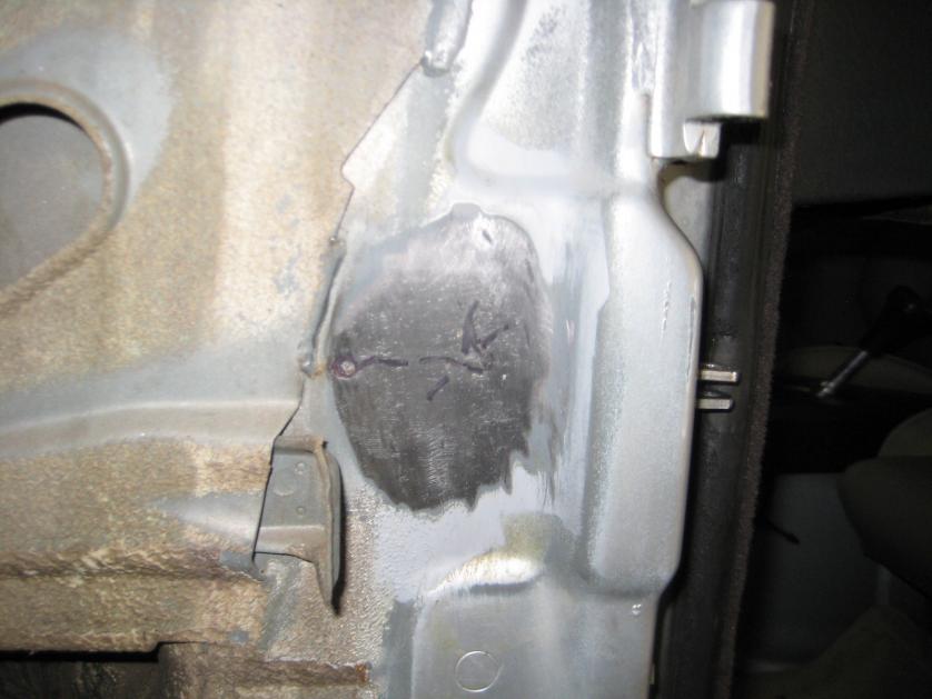

                    • tomstin
                      • Mar 2015
                      • 553
                      Mine was making a horrible popping noise when I opened the door. It appears that bracket is spot welded to the outside A pillar and the door side of the A pillar. I could never seem to reach the inside of the pillar (I didn't try removing the dash). I ended up carefully drilling through the spot welds, drilling the A pillar slightly larger and tapping the bracket. Then using three bolts, lock washers and thread locker securing the bracket to the A pillar.
                      In the attached picture I highlighted the cracks with sharpie and you can see the outline of the spot welds. I hope this helps.
Name:	Door brake body side.jpg

                      • adamnur
                        • May 2013
                        • 37
                        It's a bit late but thank you very much for your post. Absolutely helped me to locate the same issue on mine.
