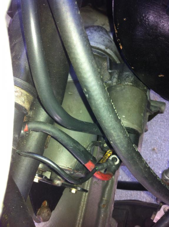

                      So I replaced the starter, but while I was in there I noticed that I have a wire near the starter that isn't connected to anything. I have attached a picture of the wire. The wire is black and green. Anyone know what this is for? I haven't tried to start the car yet. I would like to know if this wire is supposed to be connected to the starter first. Thanks for the help gentlemen. The install went quick, 50 mins.
                        Never mind, decided to use the handy search feature. Green/Black wire is the shutoff for the HVAC and other accessories when the car is trying to start. Car is operational once again. Thanks again gentlemen for all of help.

                          Where'd you end up connecting the black/green wire?
                          Chris
                            Chris
                            The black/green wire connects to the top terminal (12 o'clock position).
                              Thanks!
