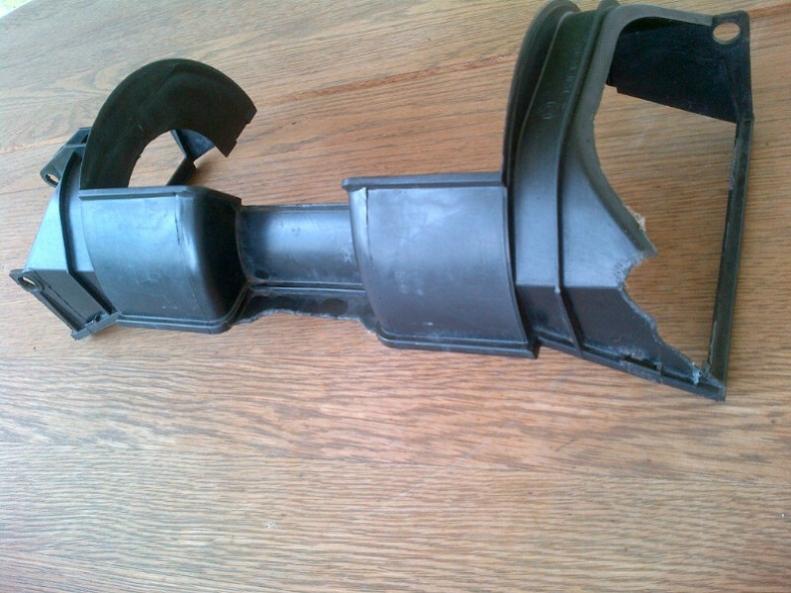

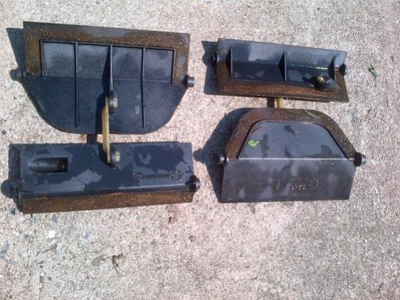

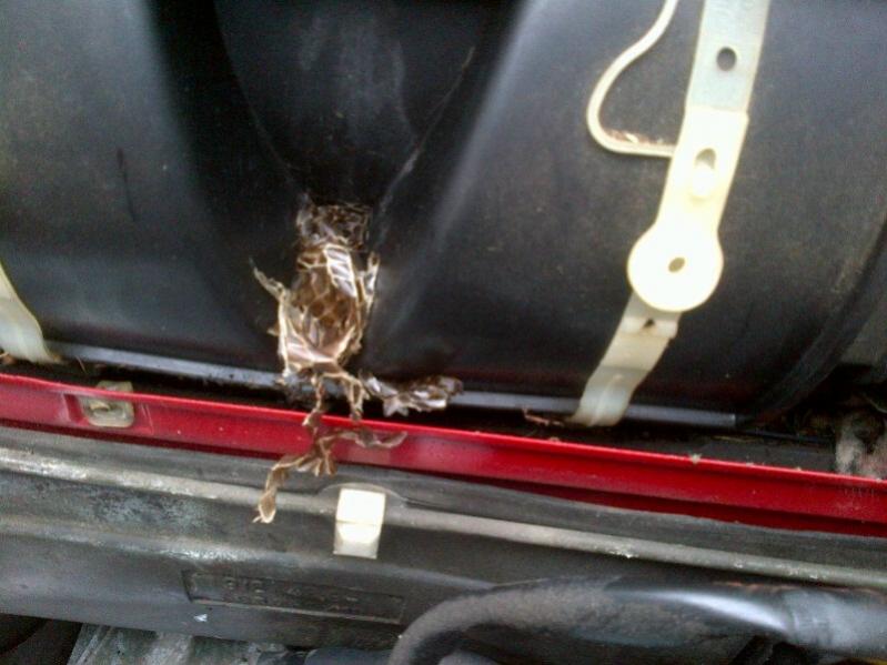

        OK...while replacing the blower resistor I found whats in the 1st pic which was clearly left behind by what ate the part in the 2nd pic. After taking it all apart I found the flaps that are in the 3rd pic.
        If you remove the firewall cover you can see the flaps which are connected by a plastic arm to each other. The smaller one is connected to an arm attached to a servo motor that sits inside the car on the HVAC unit. The arm snaps in to the metal socket you can see.
        You can listen for the servo inside or check the flaps moving behind the firewal cover.
