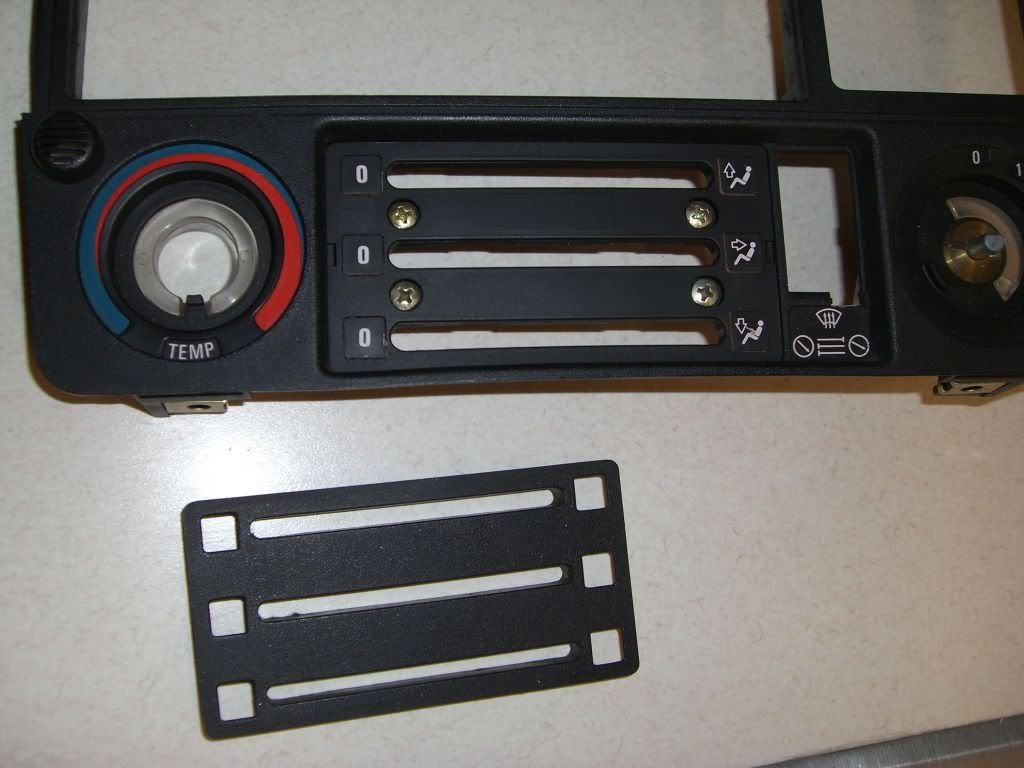

            Are you saying these two (red and yellow Xs) panels are separate?
                Yes. When the part marked with the red X is removed you'll see four screws.

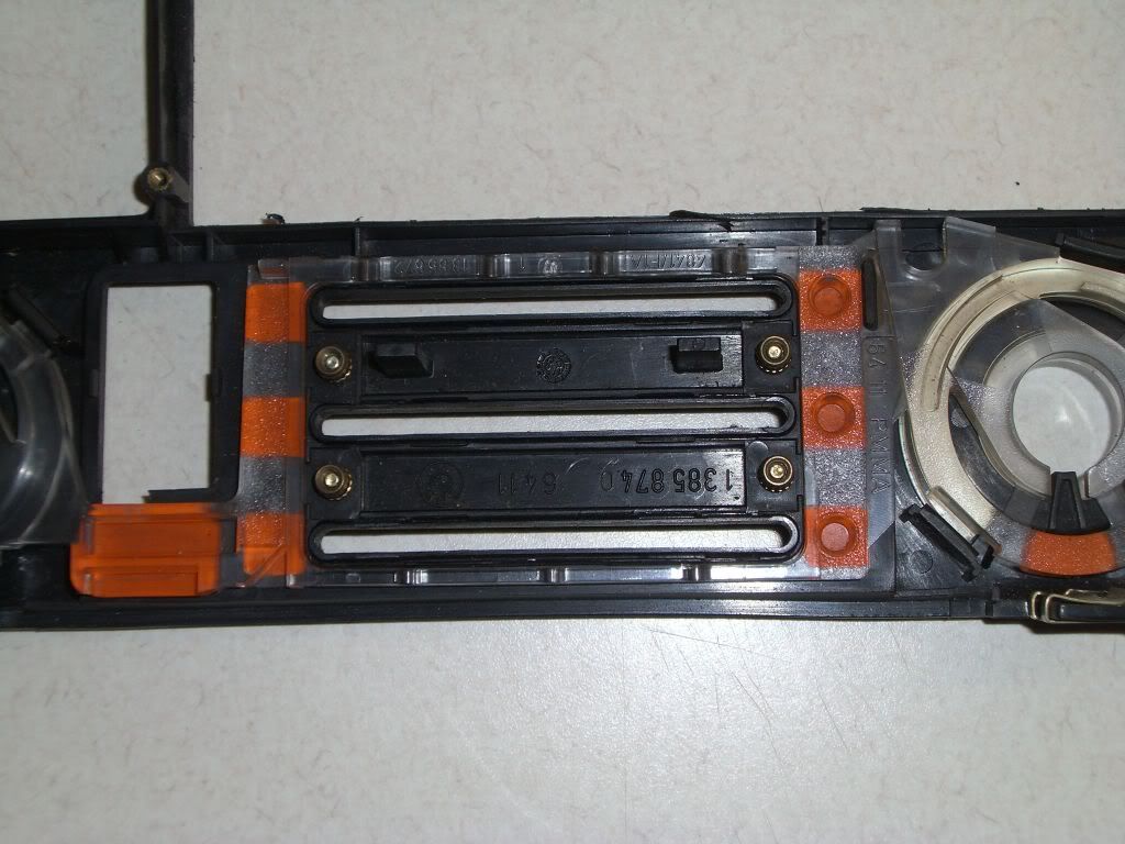

                    Maybe pics will help.
                    Here you can see the panel cover removed and the four screws underneath.

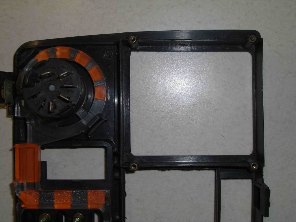

                    And here it is from the back.

                      Here is a pic of the four brass threaded inserts that hold the OBC/clock in place.
