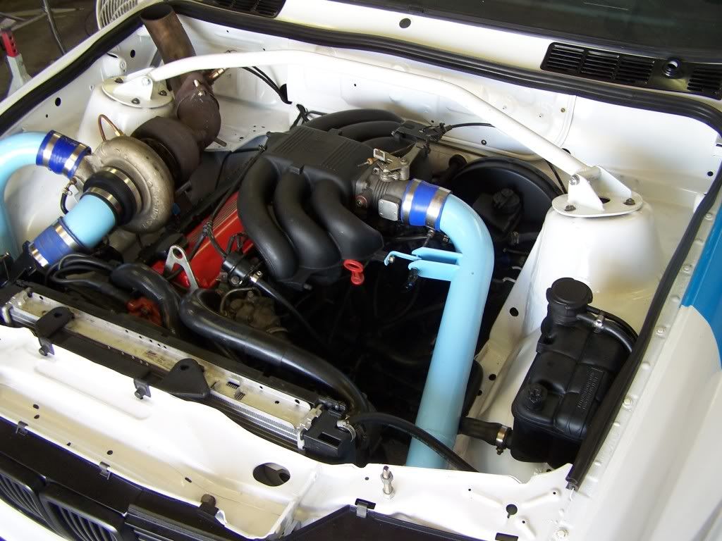

    I've searching like a mad man to find a DIY on how to remove the top part of fuse box (where the fuses are). I want to relocate my fuse box but can figure out how to get the wires out. Any bit of information is greatly appreciated at this time. Thanks

    It's easier to pull the harness through the firewall from the outside. Wires are soldered and pinned into that cover.

      Shit. That completely screws me over! Thanks

        Not really. It's just time consuming.
        You can take all the wires off the fuse box circuit board using a pin tool and re-solder a few wires, but it's a pain to do it that way.

          I think ill just leave it where it is
